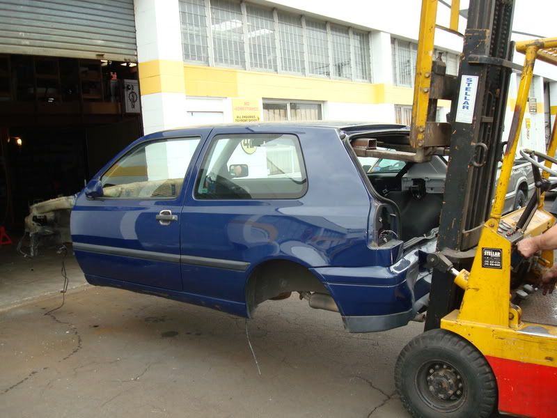

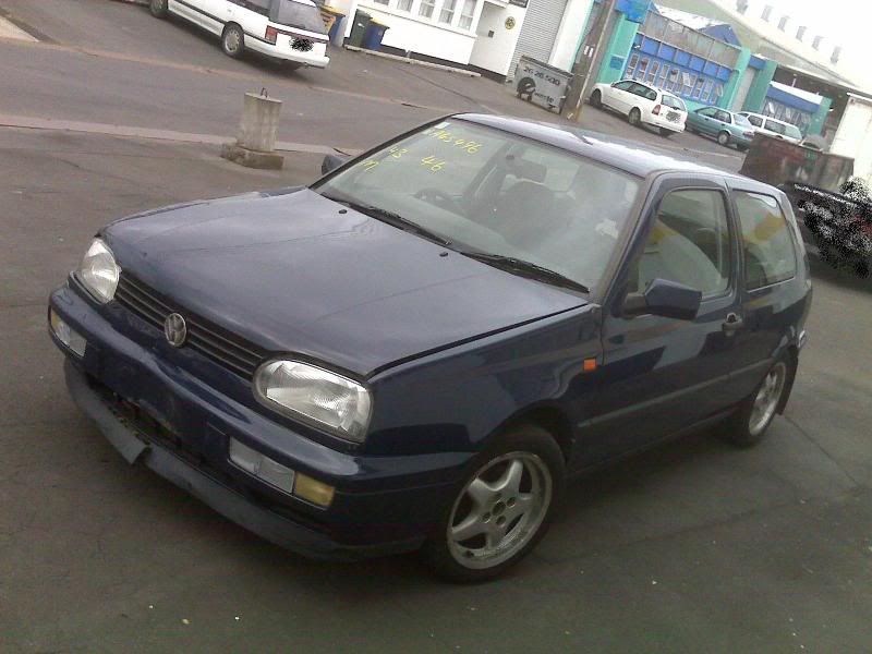

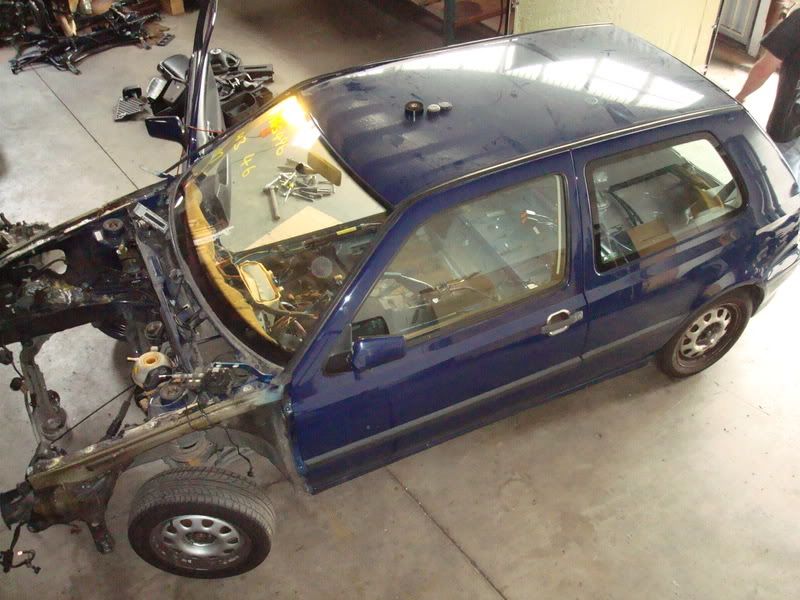

Just thought I'd kick off the new thread for the Vento coupe project. Please don't expect too many updates in the next few months as today's efforts were made to free up some space in Verts workshop. Thanks also to GTI VR6 for giving us a hand this morning - he made off with some bits as well - no idea why though  ;).
Just a few pics to start with  :)
The donor as you know started like this. 1.8 CLi with a punch in the rear.
John had already done some work during the week and after a few hours this morning with the rest of the team we progressed to this
And onwards to this  :D

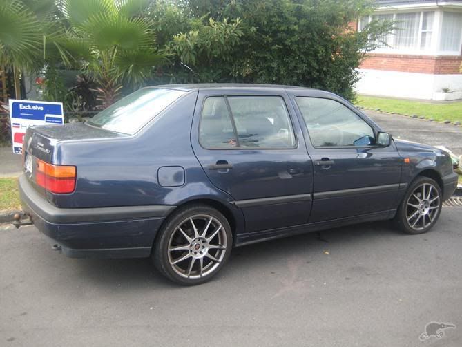

And here is a quick pic of the Vento that will be getting the make over. A nice tidy car really - shame to cut it up.  :D
So the basic plan is a 2 door Vento, 1.8T, Mk4 dash and factory electronics, nice interior, coil overs, big brakes, decent wheels, etc.

phil can you please specify what chassis is being used and where it will be chooped? im still not certain what is used how to get the coupe? is it a 3door golf with the vento boot attached?
  • Posts: 8349
Re: PROJECT CAR: Vento coupe
« Reply #2 on: April 19, 2008, 08:40:11 pm »
We will use the Vento body, chop the B pillar out and use the Golf's longer doors. The Golf's quarter panel including the B pillar will be welded into the Vento body. I still have to measure everything to decide where the best place to cut will be.

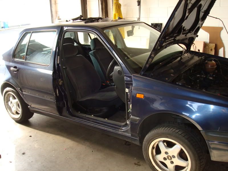

« Reply #9 on: May 24, 2008, 10:31:04 pm »
Very quick update on the Vento - nothing too interesting just spent a few hours working on it today.  :D Got it down to engine out, doors off and rolled into the corner. Next step is get her right back to her birthday suit but that will be 4 or 5 weeks away as there's other stuff to work on in the mean time.
Here's a quick picture for posterity  ;D

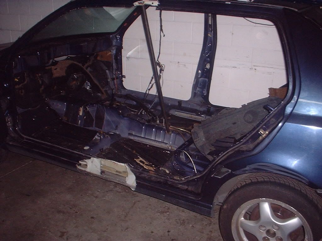

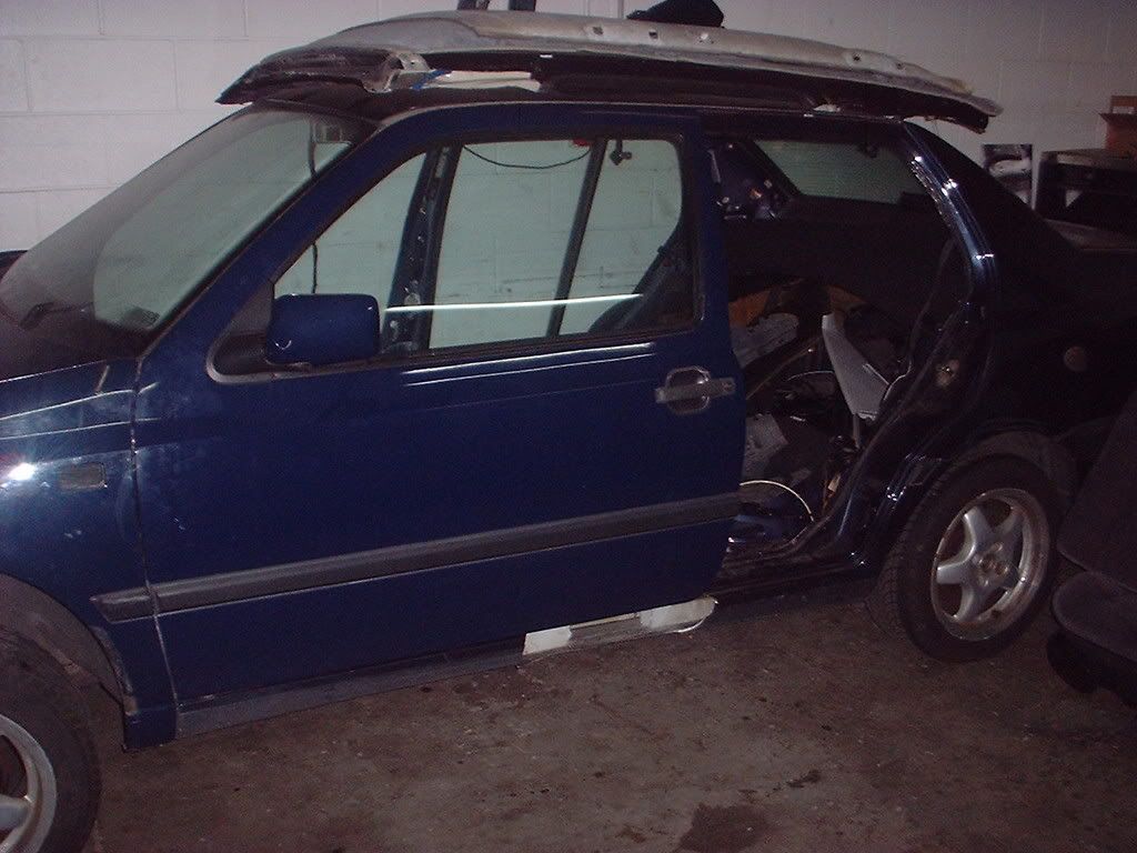

Look, there's a hole where everything was!
Welded in a brace to support the roof so that the B pillar could be cut out.
The pillar was cut right at the roofline and also through the sill, main objective being that we could test fit the larger door from the Golf.
We took a bunch of measurements from the Golf's door openining in the body so that with a bit of luck we can replicate these on the Vento body.
The rear swage line on the body lines up perfectly with the Vento's one. Next week we will cut the whole side off the Golf and start drilling it all apart to end up with the required panel incorporating the sill, B post, rear quarter and glass.

« Reply #12 on: July 12, 2008, 04:34:58 pm »
as the rear side windows look longer on the Golf than the Vento and would probably need to be cut anyway, can I make a plea for a "faster" angle at the C pillar to be more sympathetic with the slope of the back window?  more work but a much nicer outcome
the Vento C pillars don't work visually IMHO
